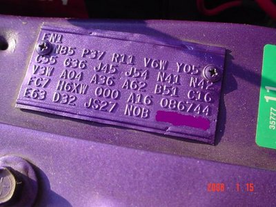

Hi all!
I've been searching for a while a JS27 car. Now I found one reasonable alternative that has a fender tag, but no build sheet. When decoding the tag I was blocked with one strangeness.
In the fender tag is the A36 code that means Performance Axle Package. As far as I know package included among the other goodies a Max Cool radiator that I suppose it was in practice meaning a 26" radiator.
If it really has had the A36 package should there be in the fender tag also stamped 26 meaning the 26" radiator that has been included in the Performance Axle Package??? Now it has not!
I have been thinking that in these days when original JS27 prices are climbing up some could have got a temptation to stamp a "homemade" fender tag, but with a little bit insufficient information about the connections of different option codes.
I have tried to seach from the internet this kind of information, but haven't found yet. Hope that someone could give reliable answer.
Thanks a lot if you can help me with this question!!!

Postby dave-r » 16 Jan 2008 11:53
Performance Axle Package (A36)
Available on cars with 4bbl or multiple carburettors. Included 3.55:1 axle gears with Sure Grip in a 8.75 inch axle, heavy duty cooling and heavy duty suspension.
I think you are correct that it would have a 26 inch radiator and "26" should be on the tag.
I don't remember seeing a 26-inch radiator car without the tag code before (but have never thought to look) and I don't have a huge collection of tag details at home so it is not impossible it was missed off sometimes or not put on in all cases.
Maybe Barry or Jack can help you out here.

Postby dave-r » 17 Jan 2008 8:47
I think it is a fake tag with options added.
The car has not got a 26-inch radiator support and having seen a photo of the tag I suspect is not as old as the car despite attempts to make it look "distressed".
If you ever have suspicions about a car like this (too low a price and things that do not quite ring true) always walk away.
I think you should give us the details of the car and seller so we can see who this guy is.

Postby Alaskan_TA » 18 Jan 2008 1:46
The tag is a fake. (for more than one reason)
Barry

Postby Automotive Engineer » 19 Jan 2008 20:32
Hi again
Last night I spent hours in the internet looking for different Mopar Fender Tags. In all cases when the car had the A36 option, in the tag was 26 indicating the 26" radiator what was included in the package.
Conclusion of this investigation was, if there is A36 in the Fender Tag, there should also be stamped 26. If it's missing, it's not the original tag and the one who has had it done, has not done his homework good enough.
The car of this case is now for sale at e-Bay where the seller is stating that the car is having the original radiator. The radiator support frame is not original while it's not having the VIN stamped on it and the radiator is 22".
So a 22" radiator in a car that by fender tag has had the A36. You all can make your conclusions from this.
This was not the only strange thing in the car. The "numbers matching" engine has the casting date only nine (9) days earlier than what was the scheduled production date in the Fender Tag.
Please, correct me, if I'm totally lost, but in the late 60's casting technology was not so developed as nowadays and at that time there was normally a few weeks (months) gap between the casting and before the block was machined and assembled to car.
If someone has registrated to e-Bay, could make an open question to the seller about the Fender Tag's A36 code and why car is not having a 26" radiator and a sign of 26 in the Tag.
It would be interesting to see what would be the answer :thumbsup:
