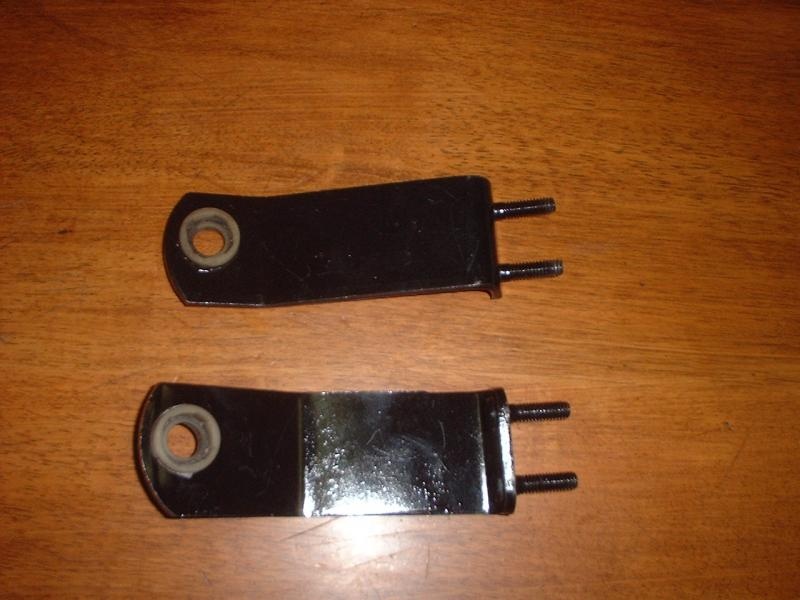

Does your transmission have one of these brackets :
The thing that must be positioned first is the front vertical pivot (I don't know what it's called, for manual trans it would be the Z-bar) which goes through the tunnel floor and into the nylon bushing of the bracket above. All the rest is installed in relation with that pivot rod (shifter brackets, and then console brackets).
